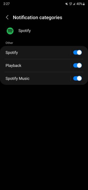

Donm long press Spotify>tap info>tap notifications>tap catagories>toggle off playback Screenshot_20220724-022714_Settings.jpg

But in the beginning I disabled Show notifications off which should include Notifications categories but it continued to show player after restart.I also did later go there and toggle ecverythung in Notifications categories off too and tested.

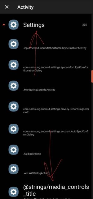

I think I found the lost setting It's hidden but it can be accessed with an app with access to the Activities, like Nova launcher. The option is called 'Pin media player'. Do you want to try?
This is the Activity to access the hidden menu.
Hi - I was wondering if you could help direct me in how to do this? I use Nova Launcher but I can't follow your instructions correctly I guess. I see the Nova Activities widget but that is just a long list that does not include the one you show. (@strings/media_controls_title). Do I need to create that activity? If yes, I don't see how to do that in Nova. I just have the pre-existing long list of activities and don't see how to create a new one. What are the required steps?
If that is not what I need to do, maybe you can just list the steps needed to get to "Pin Media Player". Step one> step 2> step 3> etc. Thanks!
I'm not sure if Samsung removed that Activity in recent updates (including Beta versions). Which model and OneUI version are you using? In previous versions is under Nova Activities - scroll down until you find 'Settings' - expand that section and it's one of the first options (see my screenshot). If you can't find it in that list there's no way to add it.Screenshot_20221013_230545.jpg
Thanks! That helped. I found it and switched it off and that stopped the playback notification. It was frustrating not only because I don't want it, but the song in the notification was something played a few weeks, and about 500 songs ago! It is a bit crazy that it is hidden so deep and only in Nova. I imagine a lot of folks would want to turn that off.

Excellent, glad it helped. That notification setting was available for Samsung devices in previous Android versions. I guess most users, like myself, had it turned off and the selection was restored in their new device/version.

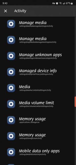

Had to do a factory erase of my phone recently and used Smart Switch and got everything pretty much back to how it was. Then the Spotify player issue came back and I had to use the fix mentioned here using Nova Launcher again and worked like a charm.
Just posting because I noticed one change and wanted to update this post in case others experience this and need the fix.
The string originally mentioned has been changed to just Media.

Idk if they removed the activity or what because I cannot find it at all in the Activities>Settings dropdown menu
