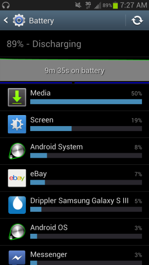

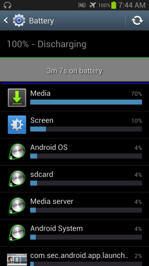

is there any other way to stop media from draining my battery. one of the ways was to remove the sd card, but i need it and dont want to. ill post up a screenshot of the problem.

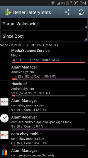

This is media draining my battery.

Try unmounting and removing the SD card, and then reinserting it. I seem to recall reading somewhere that might resolve this issue.

I had battery drain issue with "Media" application. It was trying to download a pdf or something. I cancelled all downloads and my problem solved.
Based on usage your battery will drain much faster. The rate of drain you report though is obviously much higher than it should be. Try removing the micro SD card as that has been known to be a possible read issue that leads to battery drain with the newest Jelly bean update.
