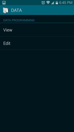

3.) Now you will need to select Edit (change mode):

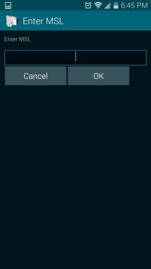

4.)Now you will need to input your MSL number you obtained (you can still view without a MSL number but you will not be able to change anything):

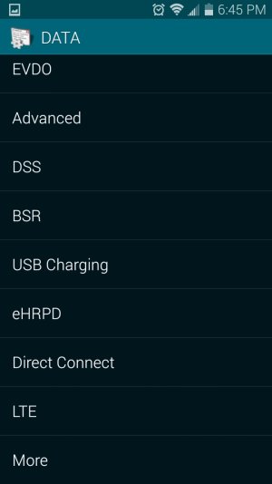

5.) Now that you are in the Data Programming menu, scroll to the bottom and select LTE:

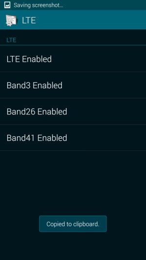

6.)Now you are in the LTE portion. Click LTE Enabled:

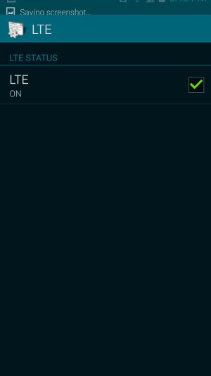

7.) Now mine was deselected and said it was off. This all came about because I was snooping for snoop sake and found this off so I turned it on by checking it:
8.) I also checked each Band (3, 26, 41). My band 3 was off so I turned it on as well.

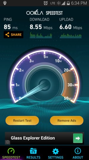

10.) When it came on...LTE!!!!! Keep in mind I was by a tower that was known to have the LTE upgrade.
Many thanks to Moderator lilotimz @ Community Blog List - Sprint 4G Rollout Updates for the help and the spark that started my curiosity.
Feel free to ask any questions! :D
Here is my first speed test with LTE on sprint! Excited!!
