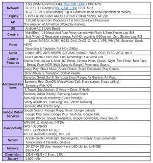

I think I just answered my question...
Sent from my SPH-L710 using Android Central Forums
They definitely don't have enough LTE to even dare try that..
