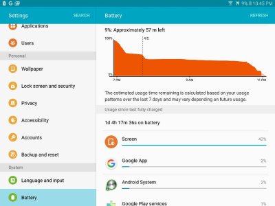

Check out the battery usage graph:
So from the 7pm on the left that usage is almost entirely with the tablet in standby. And it just drops like a rock! Weirdly enough it doesn't say anything is being used abnormally in the battery percentages, just all the normal stuff. Then when it levels off is when I put it in Airplane mode. The next drop is me actually using it and then it in standby mode for the next day.
