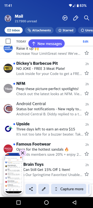

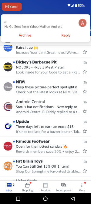

I am using a Pixel 6. When I get an email, text, FB message...anything really, it drops down for a few seconds and then goes away. There are no longer little icons in the status bar showing me that I have an unread text. So for example, if I'm on FB and I look up for a few seconds and during that time I get a text and the drop down notification goes away before I look back down, I have no idea that I just missed a text. It used to work. I was using Do Not Disturb for a little while but then I turned that off once I read that might be the cause. Still no change. It got the March update yesterday but this was happening before that.
You don't even see the overflow dot? Can you show us a screenshot of the status bar?
I figured it out! It was this app I was using called Power Shade. I uninstalled it and it started working again. Reinstalled it and has been working fine so far so idk, we will see. Thank you all!
