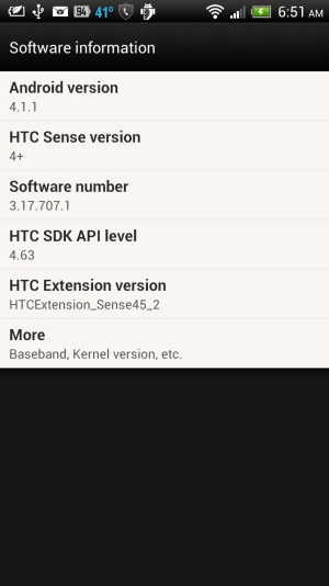

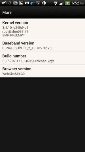

Slowly I am learning, I don't understand all the terms and procedures yet, but learning on a trial and error method. This seems to be the only place I have found to get some help other than the XDA site and haven't posted any problems there but managed to find some sort of relevant question and answer. I did manage to find a Jelly Bean rom and get it to work with little problem , but a lot of errors in trying. Think I might brave another one.
