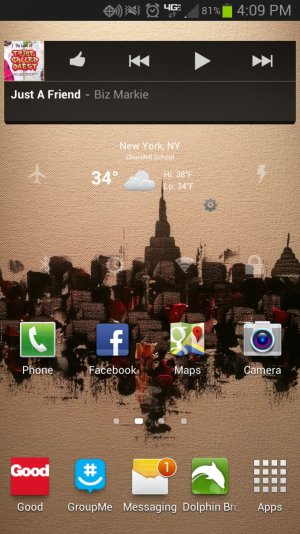

Hi everyone,
I only use the stock messaging app. As of today it is apparently stuck at "1" under the notification. i tried to open up all the texts to get ride of it but cant. Also restarted, rebooted and cleared the app data the phone but no luck.
any advice?
thanks!

thats for the advice, but still didnt work. i tried to manuall click all my messages and back out of each one and that didn't work. i did the delete app from dock and restart with no luck also
what about trying clearing the data from the messenger app
nope...theres a few apps in the play store that cover this...trying them now
sms cleaner just deleted all my texts and didnt fix the problem....trying reset sms now
just to close this out for anyone searching this...go to application manager - all apps - "badgeprovider" - clear data - restart phone

Thanks brent dobbin, Ive just read your post and I too had the same problem with the notification 1 the message envelope, then tried your quick easy step with removing it and it totally worked!! It was becoming annyoying to say the very least, thanks for your tip, it helped a great deal.
I have an LG G2 and I have a notification stuck as I was deleting the texts from a contact and they sent an incoming text. I went to all apps but do not see the badg...thing you mentioned.

Just registered as a member so I could say THANK YOU to ecs180, holy cow I was going nuts with my facebook icon frozen with 2 notifications for months now! Followed your instructions and had it fixed in 30 seconds flat. Thank you!!!
