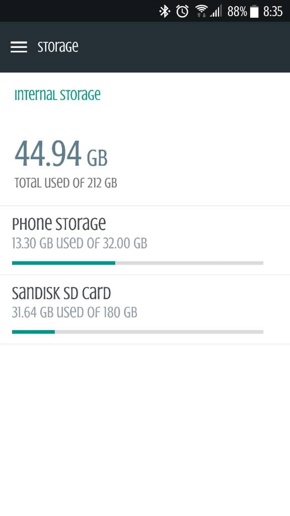

see the thing is I use Google music and I have all my music uploaded some using adaptive storage is fine for me. also I don't think what is being said is quite right because when you connect the phone to the computer using adaptive storage only the SD card shows up and I put a lot of videos on it about 35 gigs and it did not go to my internal storage but to the SD card and I have it formated yo internal memory.

I am having the exact same experience with my HTC One A9. It has 32GB native internal memory. I installed a 128GB sd card and formatted it as internal (adopted) storage, thinking from HTC's phone descriptions that this meant I could essentially expand the phone's storage. After formatting, I performed the suggested migration routine to move data to the sd card. I have 28.76GB of 32GB used of phone storage, and 2.59GB of 117GB used of sd card. It's pretty ridiculous, this very nice SanDisk sd card I purchased is almost not getting used. I soon started getting all sorts of google apps failing to load. Turned out it was because my phone storage was almost completely full. All of my pics, vids, and new apps are still getting saved to the phone storage with no way to select to save to the sd card. I had to manually go through and move apps to the sd card to get my google apps to work. Turns out you can only move certain apps that are set to allow for it. I would say Android's current implementation of using sd cards as internal storage is rather misleading, or at least HTC's representation of it is. I really don't get the reason it can't just be merged with the phone storage. Everyone keeps saying if it was all treated as the same storage and your sd card failed, it would render your phone useless. Well woop dee doo, if any of the phone storage fails, my phone could be rendered useless. At the very least, give users the option to format as "merged" memory in addition to the current implementation. I'd rather have something that works well than this current misleading implementation that sucks as far as I'm concerned.

I had the same problem with a 32GB card, and got everything to work.
It is important to understand, that using the card as internal memory, it must replace the standard sdcard, which then become phone storage - otherwise the card is used as an alternative storage, e.g. as external storage for individual apps.
First you must format the new sdcard to internal storage. Then let the phone move data from the standard sdcard to the new one and convert the standard sdcard to phone memory. As I recall, I found the Move function in Phone storage settings (the 3 dots).
