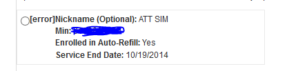

When I was trying to transfer my service back to my AT&T SIM card on my own, I noticed that my card popped up in the list of devices with that weird [error] before the nickname part. None of my other devices have this issue. It is not visible on the device view when I am in my account information, only when I try to transfer my services. This leads me to wonder if the issue I am having with no service on the SIM that I received service on before transferring from and back to is because of the SIM card itself.

I spoke with a representative. They are sending a replacement SIM card. Apparently, once you deactivate a SIM card it is no longer usable. (I wish the first representative would have said something when I asked them to transfer it back).
Sybil: It would depend. What happened was your SIM card has been deactivated. The SIM card can no longer be used since the SIM card is already expired. You will receive the same SIM card with the one that you are trying to activate. Please allow me a few minutes as I work on your account.
It is - it's just like an SD card. The "once it's deactivated, it can't be used again" is a Straight Talk rule, not a technical limitation. (BTW, the account is registered for a particular SIM. You can't use an old SIM once you get a new one on any carrier. They can reprogram the old SIM for a different account or reset your account to use the old SIM card, but AT&T will give you a new SIM if yours goes bad for nothing. I think TMobile still does. Only the MVNOs charge for SIMS - and it's a terrific overcharge, since they're only worth a few cents wholesale.)
