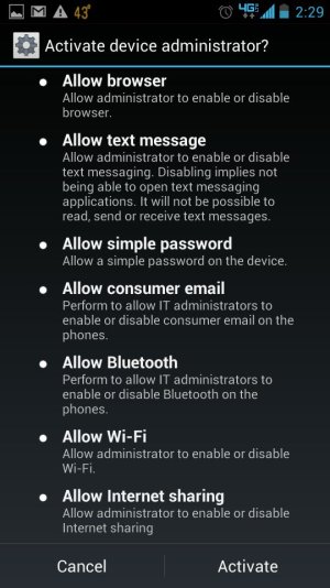

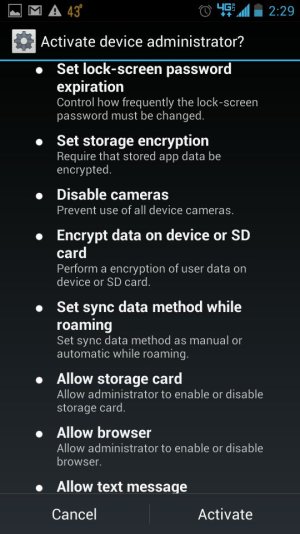

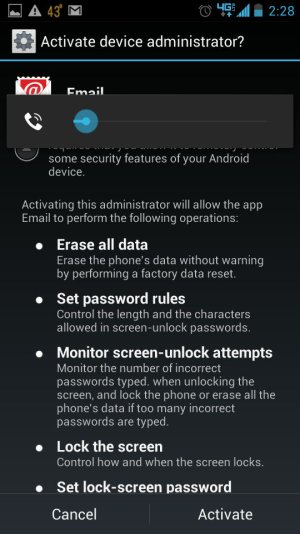

Strange corporate email security warning after JB update
Talked to the IT guy and he has no idea why the popup is happening. They are running exchange 2007.
Sent from my DROID RAZR using Tapatalk 2
Everything I have found does refer to exchange 2007 requiring it to function, but it is an exchange server side request. It does appear to have happened after JB update as you mentioned.
The IT guy needs to look at the settings and change them in exchange if you would like more relaxed security enforced. I never blocked the camera or enforced encryption like his does, but if he is willing he can change any of those. I recommend at least keeping the pin option for basic security.

Well, this is my personal phone, and I have my work email set up on it as a convenience for work so that I can get and answer emails 24/7. They really don't need to specify any security rules other that the password for that email account.

Same thing happened to me - set up corporate email on my personal Razr Maxx on ICS and did not get the warning. Updated to JB, and before I could go further I had to accept the security profile. The way I see it, is, if I want work email on my personal phone, I have to accept the security profile. Or, I can choose to not have work email on my personal phone and deal with it. Now, I do get reimbursed for a portion of my bill from work, so I went ahead and chose to accept the security profile. If you don't want work having that much control over your personal phone, then I would suggest not accepting the security profile. If you need work email 24/7, then lobby for a work provided phone, or use web based email.
When setting up my Exchange email on the default mail app I would get the device administrator warning. I then set it up using the enhanced email app and I did not get the warning. That is worth the $10 that the app costs.
Good news on the advanced email option. Did you install advanced email after installing default email?
I may be wrong on this but I believe you have to remove the certificate under administration, then try installing advanced email again and see if it prompts you or not.
Trying it right now.
Sent from my DROID RAZR using Android Central Forums
I uninstalled both default and advanced email. The device administration was removed. Reinstalled advanced email but it hasn't downloaded email between now and previous post. 20 minutes I think.
Edit: turns out I didn't have the server full name. Worked with no problems and no device administrator needed. You don't get task, which I use but for email and calendar it works fine.
Awesome! There is your solution.
