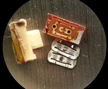

So I just had this happen to me as well. No warning. I found it odd the button still clicked and moved fine, but it was clearly electrically "stuck" on.
I took it apart and didn't see anything obvious. In the end I removed the switch so I could use the phone again. I'll just have to set my screen timeout really short. lol.
But I did a postmortem on the switch. I carefully took the switch apart. Turns out there are two tiny slightly curved contacts that form the "click" part, that short out to the "back" of the button when pressed. These contacts appear to be silver coated spring steel. What happened is a microscopic (yes I was using a 40x stereo microscope) flake of silver came off the contacts and bridged between the contact and the back of the switch. Seems like it is essentially a manufacturing flaw in the switch.
