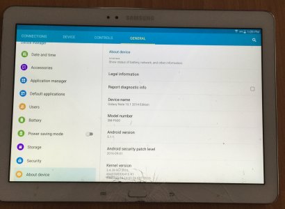

Stuck on SAMSUNG after attempt cache wipe
Sooo this happened. hubby wanted to open the case back up to check connections. could not find the tool that we had from the battery change, that we used last month to add some solder, so he tried to use an exacto knife. Tried very carefully........ then... crrraackkk. the $#%& screen cracked. arghhhhh!
i love this tablet, but after looking into us doing the screen replace, seemed too intense. UbreakIfix wants $275 to do it. Nuts to put that much money into a 3 year device that has issues.

So are you confirming that after I do a reset, it will still be rooted and I should flash it back to the original rom? Hmm guess I need to re find that info on how to do that.
Can you be so kind as to point me in the right direction to unroot my note?

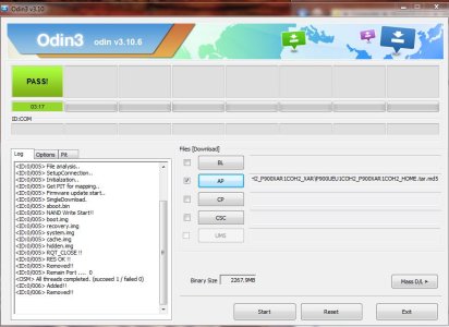

I don't know exactly your model , but search sammobile.Com for your firmware, download and flash by odin, it will return to official state.
This is the firmware for Wifi model SM-P600, instruction also is on the page

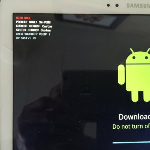

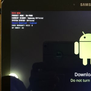

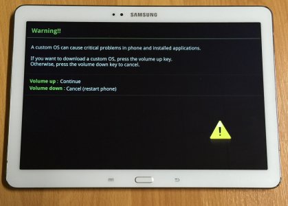

You only need Power+ Volume Down ( next to Power button ) , then Volume Up to acess Download mode ( Odin Mode ).
It takes only around 3 minutes to complete , this is an example of a Note Pro 12.2
After you're done, come back to Download Mode to verify its status is Official
or Settings-->About device-->Status, Device status should show Official

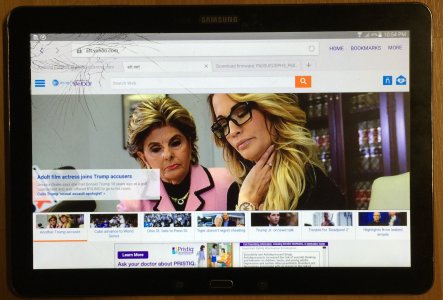

If only the touchscreen gets cracked, your tablet is still usable. I have one too, bought a tempered glass from China ( $8 ) to cover the touchscreen, then the cracks won't bother my finger. This Note Pro 907A I bought only $120, use it for testing parts.

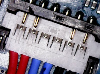

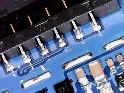

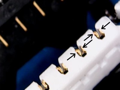

You can try to resolder the battery connector as you cannot see its hairline cracks without microscope. Unplug and plug in the battery again can solve the issue of charging because the white battery connector might make a good contact with pins of black battery connector. Here is the case of not charging, two cables on the left have no contact
When plug back, it might have a good contact again like this
This issue can fix easily by adjusting the tips of battery cable closer
You might see this issue again with your new Note 2014 as this is a flaw in all Samsung tablets, not seriously catching fire like the Galaxy Note 7 phone. However, intermittent charging, overheating, auto reboot, auto shutdown, battery capacity fluctuation...etc....all come from battery connectors, but the majority of problems is the black battery connector with hairline cracks.

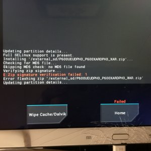

went back into twrp and did power down, tried reboot, same thing.., starts to boot, gets to SAMSUNG and hangs
TWRP is not able to flash a ROM if somehow it can not be done via Odin

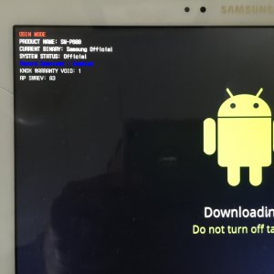

Finally I am able to bring OS back to your tablet by using a custom ROM because it failed with the official firmware. Flashed it with TWRP to make this tablet accessible via Odin.
Then I flashed with official firmware to bring it to official status, however, the Knox Warranty Void still be 1. This is OK as it's not in warranty anyway.

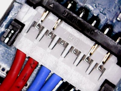

Your battery connector looked very solid even with a close up like this.
However, pushing it gently it moved, that the way I can tell it has hairline cracks under the surface. After fixing it, your tablet works normally now without a hitch
