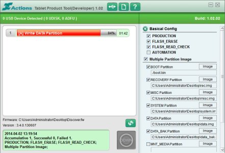

Sir i have ainol novo 8 discover it has a problem that when i install firmware files on my discover with firmware tool there have a problem is data.img file cant install on my tblet software shows WRITE DATA PARTITION FAILED..and u can see screen shot also plzzzz help me what i do.plzz thanks in advance.
