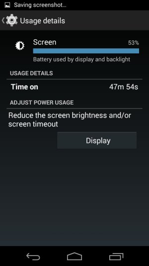

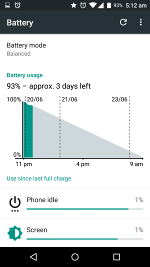

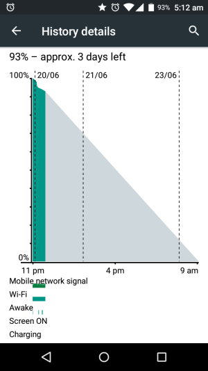

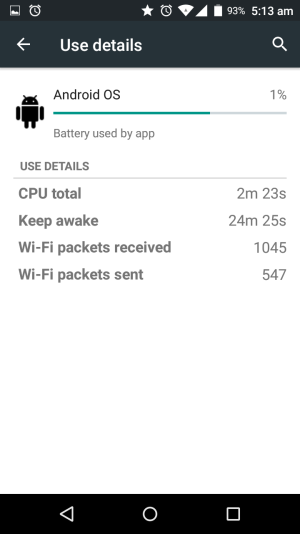

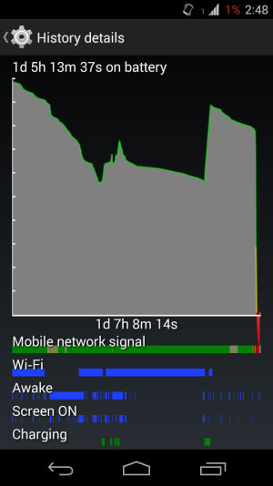

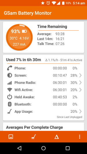

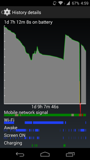

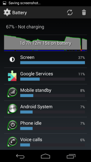

Ok so I had this issue once again. The phone was on around 64% and suddenly fell to 1%. Restarting the phone brought the battery % back to normal. I read that the solution is to charge the phone all the way to 100% and I did so last nightbut there was some battery drain even after I went to sleep and the phone wasn't even touched for 6 hours. Here are the screenshots:
PS: Does the speed of WiFi affect battery usage? When my phone was connected to the WiFi, there was a huge download going on in my laptop so that download was taking up most of the bandwidth.

I don't see anything wrong in your battery stats. It's quite difficult to know if there's something wrong after using your phone for such a little time. Much better if you wait until your battery has 30% left or so. 6 hours since full charge and 10 minutes SOT is not terrible for just 7‰ of your battery juice.
About the slow WiFi. I don't think that's going to make a big difference. Just that your screen will be on for a longer time waiting for the data being loaded.

Oh, it's just the sudden dip in the graph that got me concerned... An update is available for the ROM I'm using. I'll try it and see what happens...

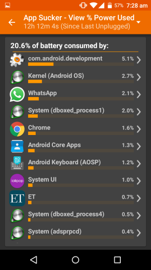

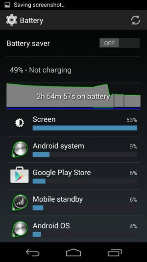

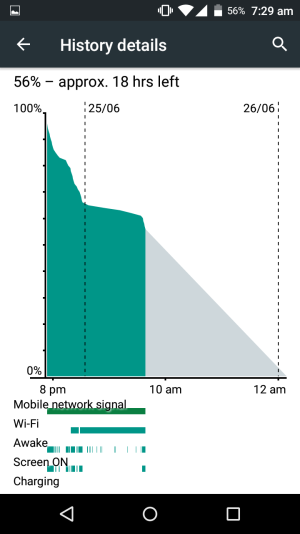

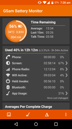

Ok so I thought that I'd use a ROM for at least a week before trying to figure out if the battery is working fine. Here are a couple of screenshots...

Those screenshots look perfectly fine to me. From the graph, you can see the battery depleting rapidly during the times when its "awake" and when the screen is on. Then it levels off (presumably) overnight when you're asleep but there is still some drain due to WiFi being on and Cellular Network being connected which is also completely normal. You can reduce this by putting it into airplane mode, turning off WiFi and Bluetooth etc but the amount you save will be fairly inconsequential compared to the amount that gets drained when you start using it through the day. You look like you are going to get over 24 hours and you already have roughly 3 hours screen on time so not sure you can expect any more from any phone.
The sudden drops in battery life highlighted in previous posts is something I have had on both the 1st gen Moto G using KitKat and my current 2nd gen Moto G with 4G using Lollipop. I suspect its a bug somewhere and it did seem to occur when I had been charging frequently and not up to the full 100%. I now try to do a full charge to 100% and if that isn't convenient then I don't worry about it too much and just wait until a time when I can do a full charge. I suspect the phone's battery stats are just not always accurate hence the issue with it suddenly appearing to drop massively. Probably only once you do a full charge do the battery stats get updated accurately.
