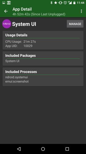

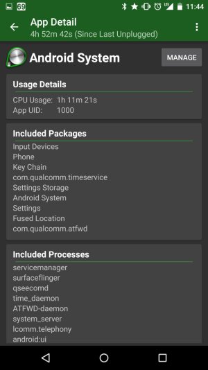

I too have noticed battery life suddenly drop since a few days ago. No difference in my usage. Android System shows as the top battery hog. Wasn't there a new version of Google Play Services that pushed out recently? Maybe that could be the issue?

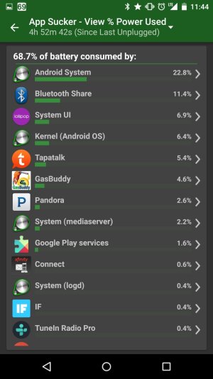

Here are some examples of my battery life today. I have never seen it drop as fast as it has this morning.

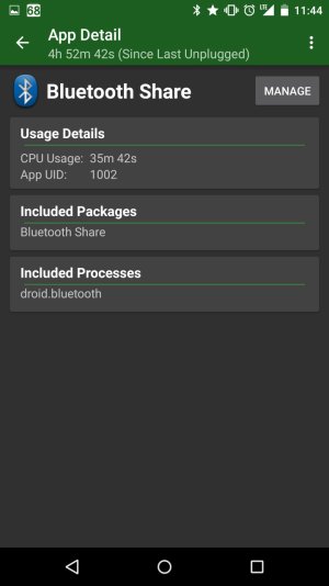

For me bluetooth seems to be using way more power that it use to. And I have not paired any new devices.
Thanks. I looked at the battery stats from Android (not GSAM), and saw that Bluetooth was keeping the phone awake almost the entire time it was on. I will try turning it off tomorrow and see how that affects battery life.

I take back what I said. Today Bluetooth kept my phone awake ever since I took it off the charger. I will just have to turn Bluetooth off while I am not using it.
Or don't use it. I had the same issues I had to stop using Bluetooth when Lollipop came out so now I keep all my speakers plugged in when listening.
Well, I use it mainly in my car for phone calls and streaming music, but that is ok since I am using a car charger. I will just get in the habit of turning Bluetooth on / off when getting in / out of the car.
