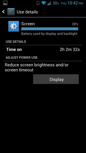

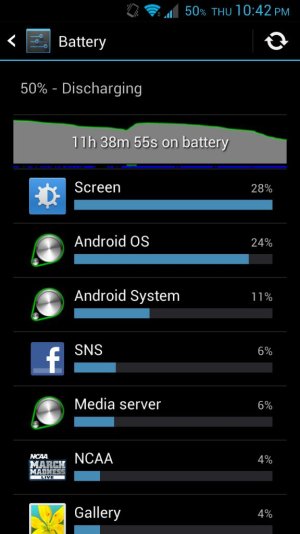

Wanted to show some battery stats. With the same use I could theoretically get nearly 24 hours and 4+ hours on screen time. Keep in mind I also streamed a couple Ncaa games for about 30 min as well.
Sent from my SCH-I535 using Android Central Forums
is that the extended battery?
Nope. Stock. It's all due to the ROM/Kernel and the settings. I would probably get even better battery life if I turned of Google services, turned off wifi when not in use, didn't stream anything (which doesn't happen often anyway) turned the brightness down some and tweaked some more of the CPU settings. But I'm good with this. I charge my phone every night so as long as I can make it to bed on a single charge, I'm good. I've been sitting at my desk at work for and hour and a half and only checked a couple emails and the battery is still at 100%.
That doesn't really count since you charged it what looks like 20-25% in the middle of the graph.
