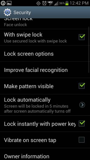

I'm not sure if this is something that can be done exactly as you wish but here's what I do and it is similar to what you're looking for.
I have my screen timeout very low but, my phone doesn't actually lock until 5 minutes after the screen turns off or if I manually turn it off using the side button.

I was going to do that, but I want to be able to hit the lock button to turn the screen off. Now that I read it more closely, it does say "Screen will be locked in 5 minutes after the screen automatically turns off". So the problem is the lock button... it actually locks the phone so it seems like there is nothing that can be done.
Correct. Like I stated, it's about as close as I can see to what you're trying to do. Using the button locks it, unless you untick that box that says lock with power key.
Actually, just uncheck the option to "lock phone instantly with power key", and it won't force you to enter your PIN/Password/Pattern until the timeout expires. At the very least I know it works with PIN lock.
