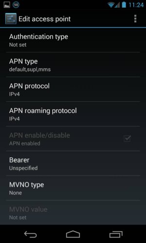

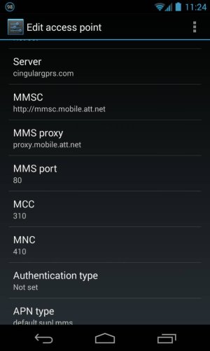

Nexy, try downloading Tweakker from the Play store on your Nexus 4. Tweakker is an APN setup program. (Try clicking on this from your Nexus 4's Chrome browser.)
Select AT&T from Tweakker. There may be multiple APNs, so try the first one. Follow the directions in the app. Once it's set up, reboot the phone and cross your fingers. After your phone is done rebooting, run another speed test to see if anything has improved. Compare that to your baseline speed test result. If there's no improvement, try another AT&T APN from Tweakker and repeat.
Well, now I'm more confused than ever! I downloaded Tweakker as you suggested. It gave me the option for "Standard", "Broadband", "LTE", and "Activation". I started with the "LTE" option and as expected, the settings they provided matched the ones everyone else is using. At home, I've been averaging 1-1.5 down and 500k-1 up. My next step was to create a new APN and set it up as basic as possible (APN: phone, APN Type: default,*) no MMS or anything. I saw the signal indicator disconnect and reconnect. This time when I ran the speed test, I was pulling between 5-6 down consistently (only slightly better than average on upload)... until I rebooted the phone. Ever since then, I've been back to my old average of 1-1.5. I obviously checked my APN to make sure nothing changed and it was still set up on the ultra basic one I had just created. Drats, I would have gladly given up MMS for solid data...
For troubleshooting sake I tried the "standard" setting (wap.cingular) and got about half of my already low average speed. That didn't surprise me at all, but I figured it was worth a shot. And broadband wouldn't even get a data connection (I suspect that's for portable wi-fi hotspots only).
So, I'm right back to where I started. I haven't been able to replicate the 5-6mbps speed again, but it does prove to me that the higher speed data exists in my area (especially since I was pulling that with half signal and consistent results 6 tests in a row). And ultimately, that frustrates me even more! The signal is there, it's got the ability to provide the speed, I'm paying for the service, and my phone should theoretically handle it all, yet something is obviously not working properly here.
Okay, you had instances where the speed improved. That's promising. Let's see if we can get it to stick.
Go back to your Nexus 4 and write down all your APNs on a piece of paper (just in case something goes wrong). Then delete each APN except for the one that gave you a speed boost. After that, reboot your phone.
Even though your Nexus 4 says its on the new APN, it behaves like it was on the old one. Deleting all the APNs except for one forces the Nexus 4 to only use one APN, and hopefully that will result in a consistent 5-6 down.
If, for some reason, nothing works at all, you can repeat the process with Tweakker or one of the APNs you wrote down. In each instance, delete any APNs except for the one you want to try, reboot, and run a speed test.

Can you please post the apn settings you are using? I am using what was auto setup when the SIM card was put in the phone.
Sent from my Nexus 4 on the Solavei network.
Changing for the better or worse?
Here is one setup that I found online.
APN Settings:
APN: pta (NOTE: IF YOU DON’T HAVE AN LTE PLAN, CHANGE THIS TO “PHONE”)
Proxy: Not set
Port: Not set
Username: Not set
Password: Not set
MMSC: http://mmsc.mobile.att.net
MMS Proxy: proxy.mobile.att.net
MMS port: 80 (NOTE: IF MMS ISN’T WORKING, CHANGE THIS TO “8080″)
MCC: 310
MNC 410
Authentication type: Not set
APN type: default,admin,fota,mms,supl,hipri
APN protocol: IPv4/IPv6
APN roaming protocol: IPv4/IPv6
Bearer: Unspecified
