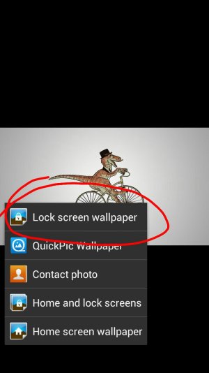

I am loving this ROM, but came across one issue. I can't set a picture as my lock screen. A stock wallpaper works but not a picture I have. It let's me crop the image and once I hit set it doesn't change and creates a weird cropped photo in my album

Figures it out and had nothing to do with wiping data, which unfortunately I did before k realized the issue. You see how there are two gallery apps? Well when you use the original gallery (yellow flower icon) and set a picture for wallpaper it works. It doesn't work with the jelly bean gallery app. It just crops the picture
