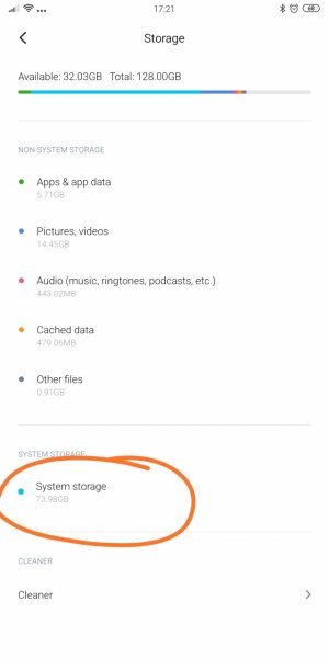

I have a 64gb internal storage, and an additional 128gb sd card that is formatted as internal storage. I recently flashed a newer version of the rom (a clean flash so wiped system, cache, dalvik etc) but now i have hardly any space as the systme storage is taking 73GB. i dont know how to get rid of it or access it, or delete stuff from it, the file manager jsut shows my pics and videos, and apps , there is nothign that should be taking this much space..

In Settings it shows my internal storage as 122gb available of 128gb (not sure why i dont also see the phones own 64Gb) but in the storage sub section, this is where i see available 32gb of 128gb, and the system storage is 74gb.

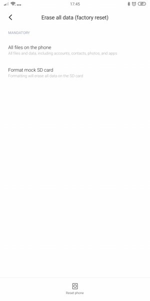

i just went to through the format sd card but the phone has "erase all data" and shows two headings 1: all files on the phone and 2 Format mock SD card.
neither are selectable or unselectable, i only have option to reset phone. If i press this it asks for my password for my Xiaomi account. is it going to auto wipe everything at this point? or will i get an option to format only the sd card?

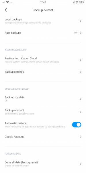

Hmm, not sure about that. Show us a screenshot of the Settings>Storage menu. Are there any options there to migrate data on the card back to phone storage?
Here are some screen shots.

nothing it just sort of flickers (as though it is supposed to be selectable) I might have to try putting the password in and hoping i can then select it, just afraid of wiping everything and being in same position after it restarts
mustang if i remove the sd card it gives a message on boot up to say it is missing, if i check the storage i now have 45gb free of 64, and the system storage is now only 10gb.
so i am better off without he 128gb sd card :)
