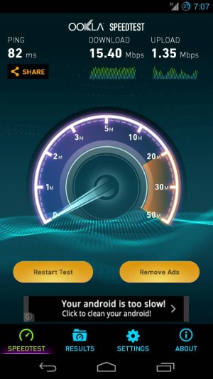

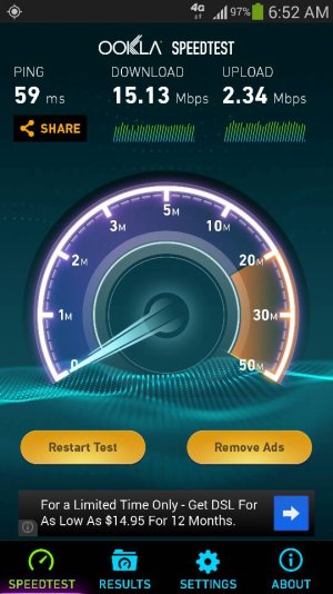

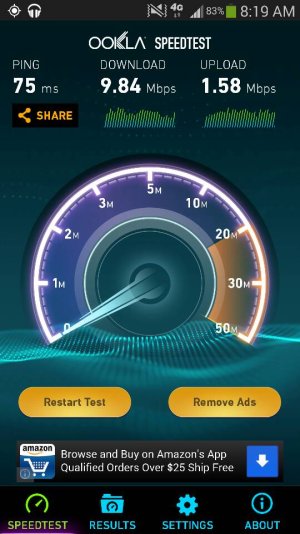

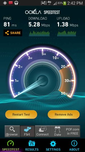

Below are various HSPA tests around town for me.
Sent from my T-Mobile Note 3 using AC Forums.

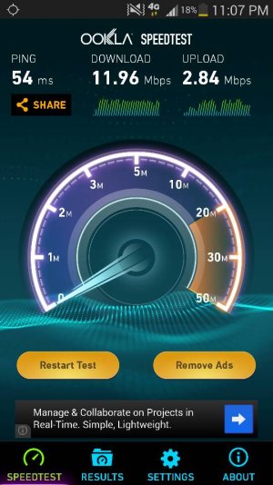

Speed test just now :)
Sent from my SGH-M919 using AC Forums mobile app
