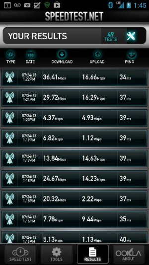

10Mhz LTE is being tested in NYC finally!
In the exact same location I am getting 36 down during mid-day. Very impressive speeds.
Penetration is the same with LTE, maybe slightly better. Difference is minor.

I was sitting in my car right across. I think it was related to the time of day.
