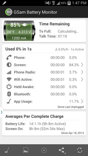

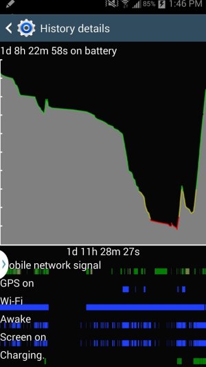

I seem to see having some issues as well. Below is my battery performance with KitKat &
1. no notifications on except Kakao Talk (Korean social message app), Lookout, Twitter, Visual Voicemail,
2. background sync on (I know this drains power, but I like getting my emails by auto sync)
3. switching to wifi when wifi is available
4. brightness set to about 35% (no auto)
5. don't have SD card
6. don't use GPS often
7. voice control-incoming call on
8. Air view pen- speed dial preview & icon label on
9. air command on
10. motion- direct call on
11. location service off
12. using GSAM battery
13. I usually charge my phone when it gets to about 10-15%
14. screen timeout to 1 minute
As you can see, android system is draining a lot of power. And is there a non-root wakelock app I can use?
I wait for your expert opinions...

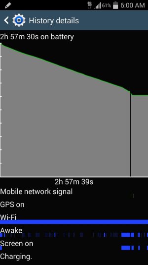

My Note 3 takes about 2.5% of battery during 8hrs of idle. This is after I upgraded it to Kitkat 4.4.2. I also installed easy battery saver app. I don't have skype installed. I do have gvoice and wechat. I turned off the features that I don't use such as voice activation etc. I'm still in the 14-day period, should I return it and get another Note 3 with Jelly Bean?

How do I upload a screen shot? I took a shot of the battery usage report and want to share and compare with you guys.
Hello, I am pretty new to android (previous iphone user), and don't have lot of experience or knowledge, but 2.5% use on 8 hours of not using sounds pretty good. Mine is like that as well.
What settings & apps are you running? How did you get 2.5%, GSAM?
I usually take the screen shot with SPen, email them to myself, uploaded unto this site using my laptop.

Quick question im new to this site but i recently purchased a s view case off of ebay and overnight my note 3 battery was on 100% i woke up next morning and it was on 64, are you not aloud to use cases for samsung phones
The majority of ebay s-view cases are fake and some fakes as well as some 3rd party knock offs have been known to drain battery but not all do.
Some things to check. Make sure the cover was staying closed first of all. Then, and I realize you were probably asleep when this happened, but you should check whether the s-view screen is coming on by itself. This can happen even with the case closed fully with some fake cases. Also, and this one applies to genuine cases as well as any other, make sure you do not have the Quick Glance feature on under Air Gestures since this is activated by the sensor being covered, which it is anytime the s-view cover is closed.
After doing numerous updates on numerous Samsung phones, starting with Eclair..you need to ALWAYS do a complete reset and partition wipe after updating firmware.
Both of those are found in recovery mode boot. It clears off anything left hanging out there from the previous firmware or previous apps you have installed before and uninstalled later and anything that just isn't working right after an update, it almost always clears that up.
Now don't do the factory reset in setting, boot into recovery, wipe the partition cache, then do the reset in the menu of recovery mode. Always plan for a reset after every single firmware upgrade you do, especially when it is a large file and this one was.
