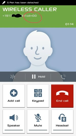

When I receive a call on wifi calling, at the end of each number there is a ;oli=63 attached. What is this and how can i remove it?
It does not happen when i am not on wifi calling. ...
I'm having the exact same issue. Been talking to T-Mobile tech support trying to solve this. Very annoying.

Yeah. .. The calls work fine for me also but incoming numbers have those digits attached so i don't recognize the phone numbers since they are not in the address book because of the extra digits.

Having the same issue with Note 3. I just called Tmobile...Here's a "Quick Fix" for internet connection & non Wifi cellular connection simultaneously.
This is NOT a solution, but it helps for now if you have cell service where you use wifi.
(If you have decent cell service where you have wifi this will help) This will take calling OFF of Wifi to receive calls non Wifi &
will also connect phone to Wifi Internet simultaneously by splitting connection.
Call Tmobile with feedback on anymore issues, as they are now aware & working to fix this problem.
STEPS ------
1) Menu
2) Settings
3) More Networks
4) Wi-Fi Calling
5) Connection Preferences
6) Cellular Network Preferred
After changing settings, give it a few mins, then try calling phone from another
phone, cell service will be on cellular signal.

They say they have been aware of issue, since Oct. 10th. They are working on a patch to send OTA as soon as possible. It's annoying as hell. Especially for something as simple as this for such a great device. I guess it's just the waiting game now
