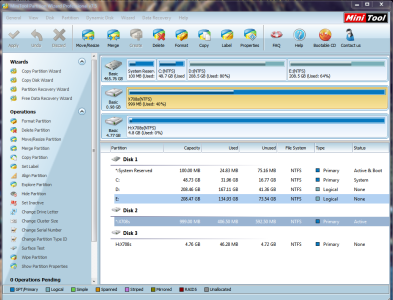

Hi guys i have a tablet and i partitioned its sd card using mini tool partition wizard pro and the newly created partition went into another hard disk like this.Capture.PNG
The partitions in disk 2 and disk 3 are my sdcards partitions.
So my device is all messed up and i can't use my sdcard and my internal space is 512mb.
Please help me.when i go to apps it shows 512mb in internal storage and shows nothing in sd card.
Please please please help me:'(
Thank you in advance:'(

Hi guys i have a tablet and i partitioned its sd card using mini tool partition wizard pro and the newly created partition went into another hard disk like this.View attachment 125425

Hi there. Have you tried doing a factory reset to see if it restores everything back?
Also I'm assuming you did it to the internal storage and not an external storage correct?
Hi I did a factory reset 5 or even more times and my internal storage has 512mb space which I didn't mess up and this tablet came with a built in internal storage (sd card) which I can't remove.so I partitioned my internal storage and reseting doesn't bring everything back.I did format my sd card.and I will check that solution of yours "to reflash the stock firmware":'(
