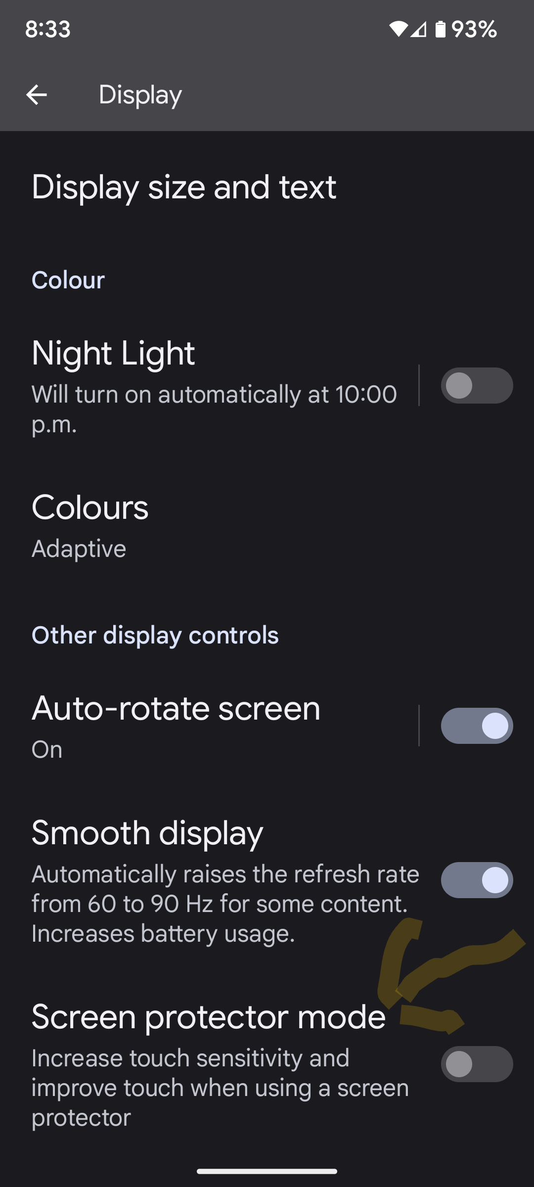

It can't just be me. Ever since I got the Pixel 7, it's done this. Sometimes when I double tap to wake my screen, it just doesn't come on. Usually another double tap will do it, and sometimes I just have to pick it up and/or press the power button. It's not something I'd exchange the phone over, but it is a bit annoying.

I've run my P6 without one for a year now, so no biggie. Try turning it on and see what happens.
