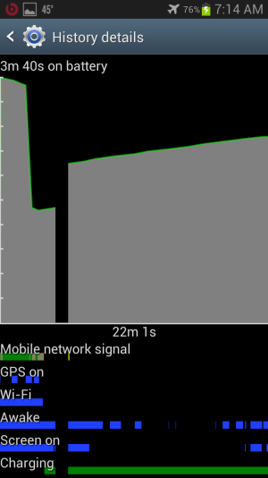

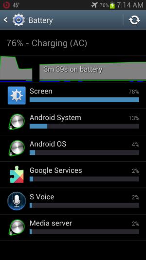

Sounds like a defective battery, what's "using" up your battery? Posting a screenshot of your battery stats would be very helpful
I'm surprised the phone didn't burst into flames during a drop like that. Did you notice the phone getting hot at all?
What were you doing when that drop occurred? It shows that the phone was awake and the screen was on the whole time. Your cellular signal seemed fine, so it wasn't that.

Edit: BTW, never charge the phone before capturing the screenshots - it makes any time-based assessment useless.

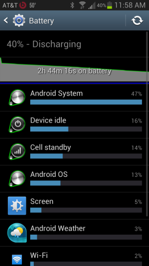

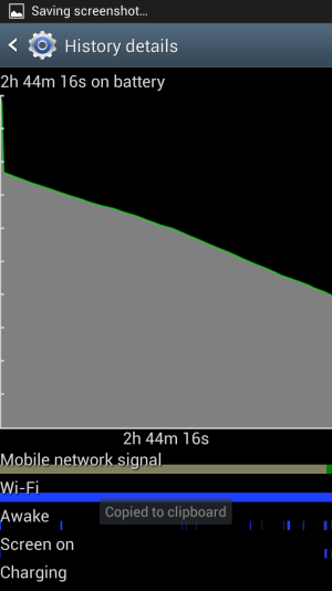

I did the same thing overnight. Turned on Airplane mode and let it charge. This morning, I simply turned Airplane mode off. No calls, no emails, no weather checks. An hour later, it's down to 41% again. A quick check at the battery says another sharp drop, but an steady, dangerous drain since.
Look closely to the left and you'll see where it dropped. I estimate another 2-3 minute death period.
