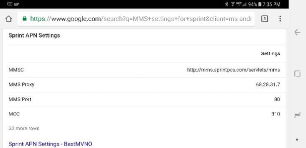

You may need to go into the advanced settings and enter the correct values for your carrier. You can Google the settings, and it's similar to this
