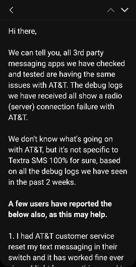

Is anyone else having issues sending texts with Textra since their recent update? I keep getting an error message saying my text failed but it's not all texts. I wasn't having this issue before they sent an update yesterday.

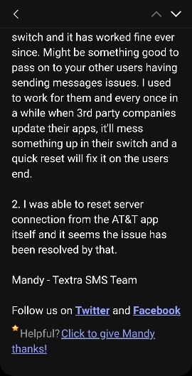

I emailed them and got an answer saying it's an at&t issue. One suggestion was to have at& t reset a switch or go into the att app and reset the connection server. The response wasn't much help to me because I have no idea what they are talking about.lol
