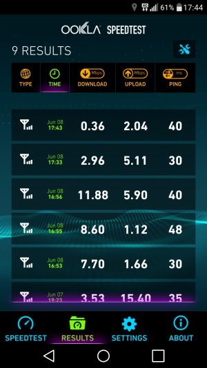

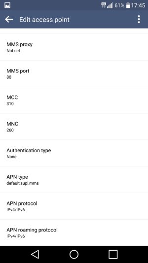

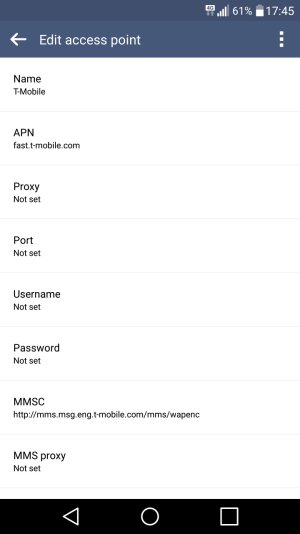

Hi would you mind sharing what settings you used to get T-mobile LTE on H815? I'm in NYC and it says "4G" on top but speed tests show much slower speeds than my old Nexus 5!! Screenshot_2015-06-08-17-44-33.jpgScreenshot_2015-06-08-17-45-08.jpgScreenshot_2015-06-08-17-45-15.jpg
