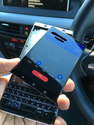

However, I'm now quite worried about the potential durability as I've been hearing of displays popping out of the chassis even after a minor drop.
Over at Crackberry, user The_Q posted a thread, showing his KEYone's display that has been detached from the chassis after a minor drop on the center console of his BMW.
Just now, YouTuber Zack Nelson of JerryRigEverything noticed that during the bend test part of his durability videos, the display popped off rather easily and noticed the lack of adhesives underneath the panel that could have stuck the display onto the chassis.

If this is indicative of a wider issue, then TCL alongside BlackBerry needs to come up with a proper solution for not only future KEYone customers but current ones as well, because if there really is no adhesive under the display on all KEYones sold so far, this can be a pretty significant issue.
We all knew the JerryRigEverything treatment was coming. :) haha.
I was crossing fingers that all went well and screens coming off was not a actual weak point for the KEYone. To be honest, i would never put my phone under that much pressure so the chance of the screen coming off is fairly low for my use case. However, I think it's a definite no no that TCL or Blackberry Mobile did not stick that screen down harder or provide any sort of adhesive to lock it down. Seems like almost nothing is holding it in place. Hopefully they can improve on this. The keyboard is great, the fingerprint sensor is great, camera is great but obviously not enough attention was given to the screen.

You don't have to bend it to force it to come out.
Even a small drop can do the same.
That needs to be addressed.
And it's definitely TCL, since they make the actual phone.

They issued an official statement.
TCL Communication has a long-standing track record of delivering high-quality devices to our customers around the world, and the BlackBerry KEYone is no different. To ensure the highest quality in the BlackBerry KEYone, we used strong, durable premium materials and conducted rigorous stress tests on the device throughout the product development cycle to meet the real life use standards our customers demand. While the BlackBerry KEYone is being met with great enthusiasm, we are aware of the concerns around potential display separation on the device. Out of the thousands of BlackBerry KEYone smartphones that have been shipped and sold globally, only a very small handful of customers have reported this kind of issue.
Our teams are actively examining additional adhesive measures that might further strengthen and eliminate any possibility of display separation occurring. If a customer does experience this however, they’re encouraged to contact us for a device warranty replacement.
