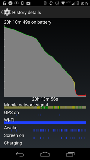

The only problem is - I've had this phone since shortly after the DE launched. And it got worse - not better. And the first discharge after receiving the "repaired" one? Same thing:
