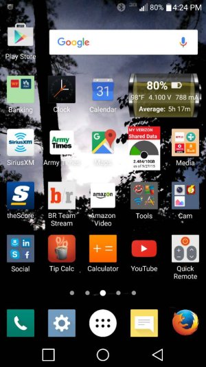

Okay, I'm beginning to think my device is totally jacked up (or possessed)...
I have never used a custom launcher, nor rooted my G4. The issues keep mounting. In the last half hour, the notification LED has stayed on solid green or blinked blue, despite my clearing all notifications. Unless the network is down (by pure coincidence), I'm also not getting any mobile network data connection, at the moment.
The Windows 7 laptop also will not recognize my G4.
To the best of my knowledge, I've never had any sort of malware or virus on this device (or any other smartphone I've owned). I've used every antivirus scanner and security app on it, I can think of.
The battery charge indicator has frozen on 80%, and this applies to Gsam as well.
My device has never been dropped or immersed in liquid, and the moisture indicator looks brand new.
I'm going to try a hard reset, unless someone can think of a better idea.
I can currently only use Wi-Fi for Data connection. Battery state is frozen at 80%.

Yeah, I turned it off, and the power-off charge showed 63%--as opposed to the 80% it was indicating while on for the longest time. Doing a full charge before I FDR everything. If this hard reset doesn't do the job, I'm afraid my device has gone bad. Which is really a shame, as for the most part, I've really thought highly of my G4. The good news, is LG Backup works very well.
Well, it looks like I'm going to need a replacement, unless someone has any better ideas; the FDR resolved nothing.
