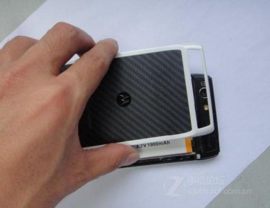

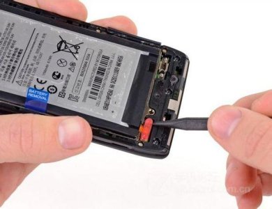

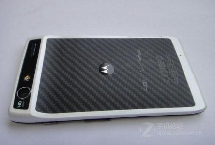

Step 1:Open the back cover(This step is easy but be careful not to pull too hard).

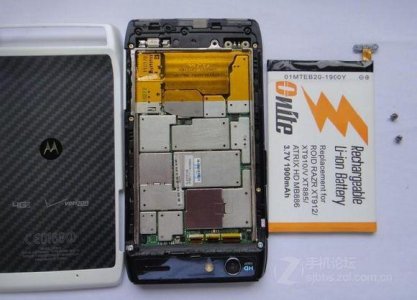

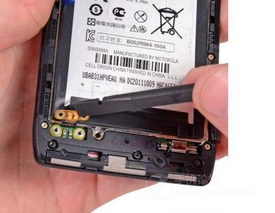

Step 2:Use T5 screwdriver to twist two screws that on the flat cable, then use tweezers to pick the flat cable gently (be careful not to lost the insulation gasket below).

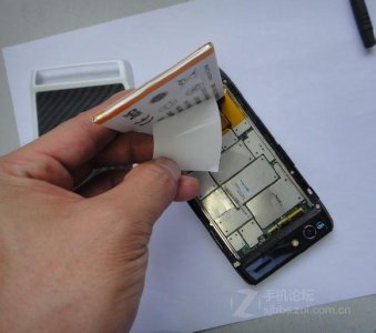

Step 3:Take out the original battery gently,then put the battery you bought.

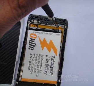

Step 4
ut the insulation gasket back that you took from the original battery,and put the screws back .(be careful do not overexert to damage the flat cable port)

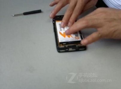

Step 5:Attach the double faced adhesive tape to the back for the battery,stick it with phone and compress it.

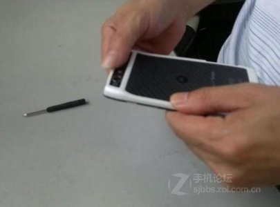

Step 6
ut the cover back.

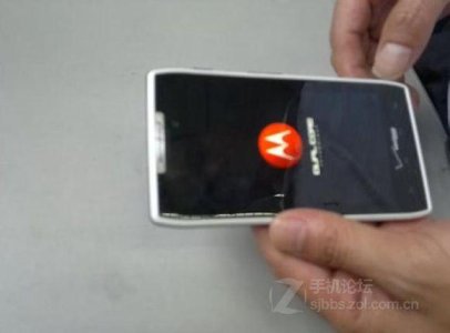

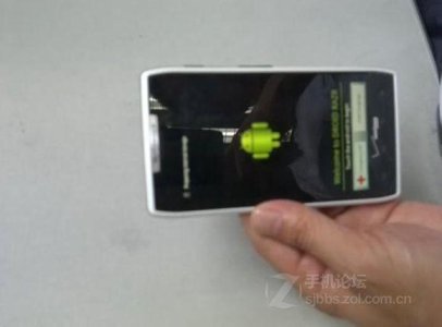

Step 7
ower on the phone.Finished.
