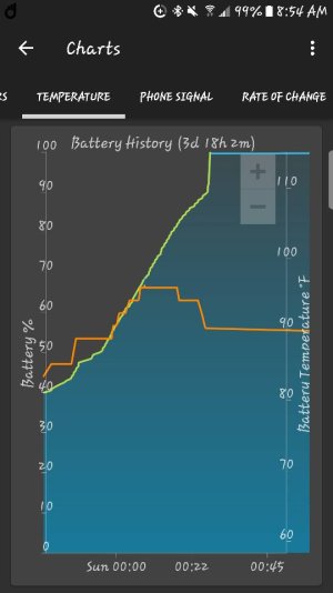

Recently I've noticed the performance my of my s7 edge has degraded. Apps are opening much slower than they used to and the phone is not able to keep them open in the background, even with only 5 apps open. On top of that I've noticed my battery drains incredibly fast, about 10 to 15% an hour. Also when charging, my phone would jump from 85% to 100% charge sometimes as shown below.
Sounds like the battery has reached the end of its natural life. Entirely your call to replace the battery or the phone. You still have a state of the art device there and battery will be the cheaper option. However... With the S9 coming out soon, you will get great deals on the S8....

The odd jumping about in battery state is certainly the sign of a dying battery. However, that doesn't necessarily explain the lagginess and inability to keep apps in memory.
Check battery usage by app and see if you have recently introduced a battery hog into the app family. It won't fix the "85% to 100% jump" or any possible shutdowns at >0%, but it can certainly help with battery life!
