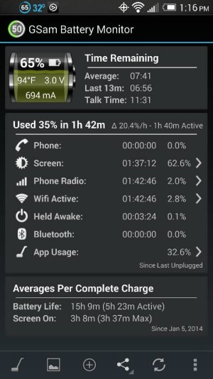

Use an app like GSam to view the sytem Kernel Wakelocks. Chances are you have a system task that is waking up the phone constantly which sucks down your battery because the phone can't go into deep sleep.
My battery usage looked like yours with Android System seemingly running away. It would be at 80%+ use and my phone was dying within seven or eight hours with limited use. Sure enough, I checked the Wakelocks and for whatever reason, my WiFi router at home was constantly polling my One keeping the phone from going into deep sleep the entire time. Turned off WiFi when at home for now and my battery life is back to normal: 18 hours regular use and longer with overnight standby.

But I'd say with those other apps so low and the phone losing 60% of battery in four hours that you have something along the lines of the wakelock issue I experienced. Or perhaps you're in an area with bad cell coverage?
That is huge drain for just 15 minutes of screen time.
You can press on "App Usage" and check out what eats up your battery.

When I went back in the app I accidentally reset it but i clicked on app usage and took a screen shot.Isnt the temp kinda high too?
Not sure if it was maybe a glitch or what but ive been using my phone for almost 15 mins and its still on 100%.Brightness on full,wifi on,and the 4g is still up there (when wifi is on).Hopefully this is working.
That's the screen I was referring to, but if you accidentally did a reset then it's no help. But you can use it to understand if anything is amiss.
