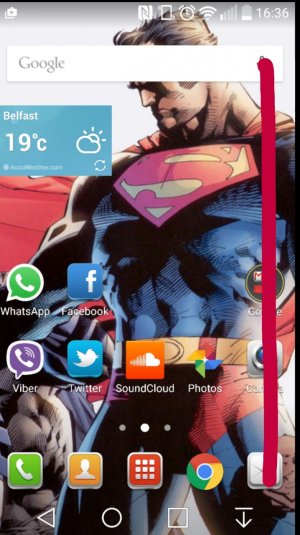

Did anyone have any luck with fixes? I've just found the same problem in the bottom right of my screen. Swype is now useless as it breaks up my words as if I'm adding a space and when I want an 'm' or '.' it presses all the buttons around it.
I've done many reboots and now just done a factory reset and the problem isn't fixed. With scanning through my apps I've worked out it is all up the right side of the screen and then a 1/3 across the bottom from the right - Down the red line and then across to the Chrome icon.

That area where the logo is contains the cable that connects the digitizer (what handles and processes touch input) to the phone's motherboard, so to speak. It sounds like your cable is either loose or malfunctioning.
See this picture below for reference:
