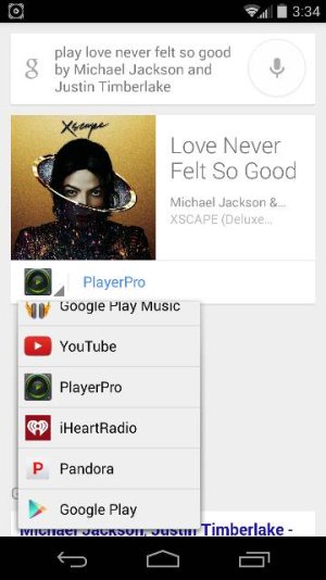

There is a bug with Google Play, use a different player I suggest PowerAmp but PlayerPRO works too, and be sure to select your new GN supported player from the drop down box
