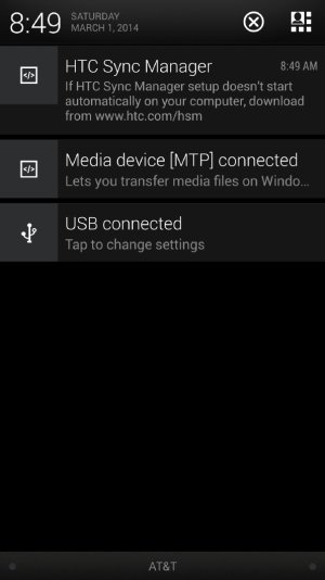

Hey there!
Today was the first time I connected my phone to the computer after updating to Kitkat. I have no idea what option I should be selecting so that my phone will connect/sync with HTC sync manager. Before the update, as you all know, there's a prompt telling you to turn on USB debugging. I no longer get a prompt after the update... There's a "USB connected" icon and a "USB debugging connected" icon that appears, and I've looked through the options for each one... But nothing really jumps out at me that I should be checking so that the phone will sync. Does anyone know anything about this?
The last time I saw this, I thought it would show you a, "tap to change connection type" option. Let me try my phone and I'll get back to you when I see the option.
So I see what your talking about. I looks like mine automatically connect it as an MTP connection, and I also can begin connecting my HTC Sync manager, etc. I'll see if I can post a screenshot for you.
After reading your post, I tried connecting my phone again, and it connected with HTC sync manager! I kept trying to disconnect and reconnect last night when HTC sync was already open, so I guess the phone doesn't sync if HTC Sync manager is already open... which is kinda lame lol. It'll sync when HTC Sync manager opens upon detecting the phone being connected to the computer. lol anyway, problem solved I guess. Thanks for replying and for your help! :D
