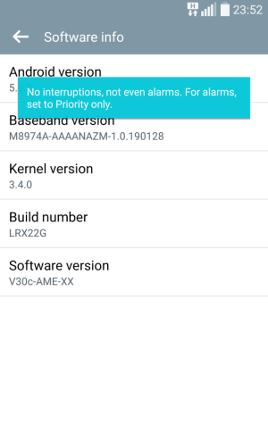

I'm on an international version of LG G2 and it's currently on Android v 5.0.2, Kernel v 3.4.0 and Software version is: V30c-AME-XX. I'm quite bored with the current software and also I'm still waiting for the next Google Nexus which might be my choice for the upgrade so until that time, I wish I can try something else that has been witnessed to be as stable as possible & give my phone a fresh new look with new features and enhancements so I'm almost settled on "Cyanogen" 12.1 for no reason other than that it is the most popular, as far as I can tell from googling around. But before starting messing up with my phone, I wanna ask:

Sorry for the bad screenshot, the Android version is 5.0.2 however
