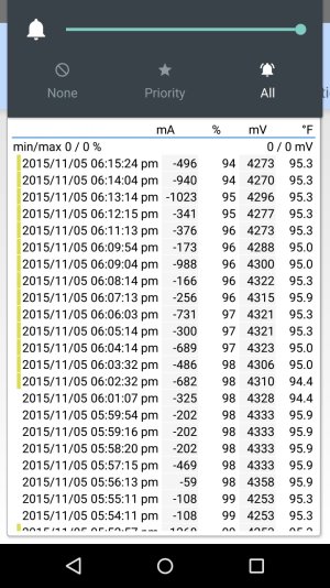

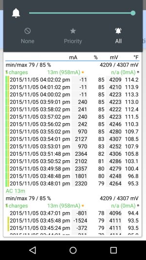

dpham, I'm not sure what you're trying to get at. Thank you for providing this data, but honestly, as I've mentioned before, the turbo charging on this phone is capable of drawing 4 amps from the charger. I'm not sure what your background is, but as an electrical engineer, that is A LOT of power for a small device as a phone. Last night my phone reached 107.9 deg F turbo charging in just an idle state at home on WIFI and it was pulling 3.959 amps. In order to validate your statements of "my note 5 was cooler", you're going to need to provide the same data with the same tests on the note 5. If my hunch is right, I'm willing to say that samsung's fast charge isn't drawing as much current. It has a smaller battery, only 3000 mAh (20% smaller) so that will decrease the time that the charging stays in the "fast mode". And the shorter the time the phone stays in "fast mode" charging, the less heat that builds.
In the end, what I'm trying to say is, you're trying to make a comparison that is not apples to apples. I've looked for the charging specs for the note 5, but I can't find them, but my gut is telling me that it just doesn't pull the same amount of current. If you're that worried about the heat, don't use the turbo charger, buy yourself a couple anker chargers that will still provide a good amount of current to keep up with the heavy loads of navigation, hotspot, etc.

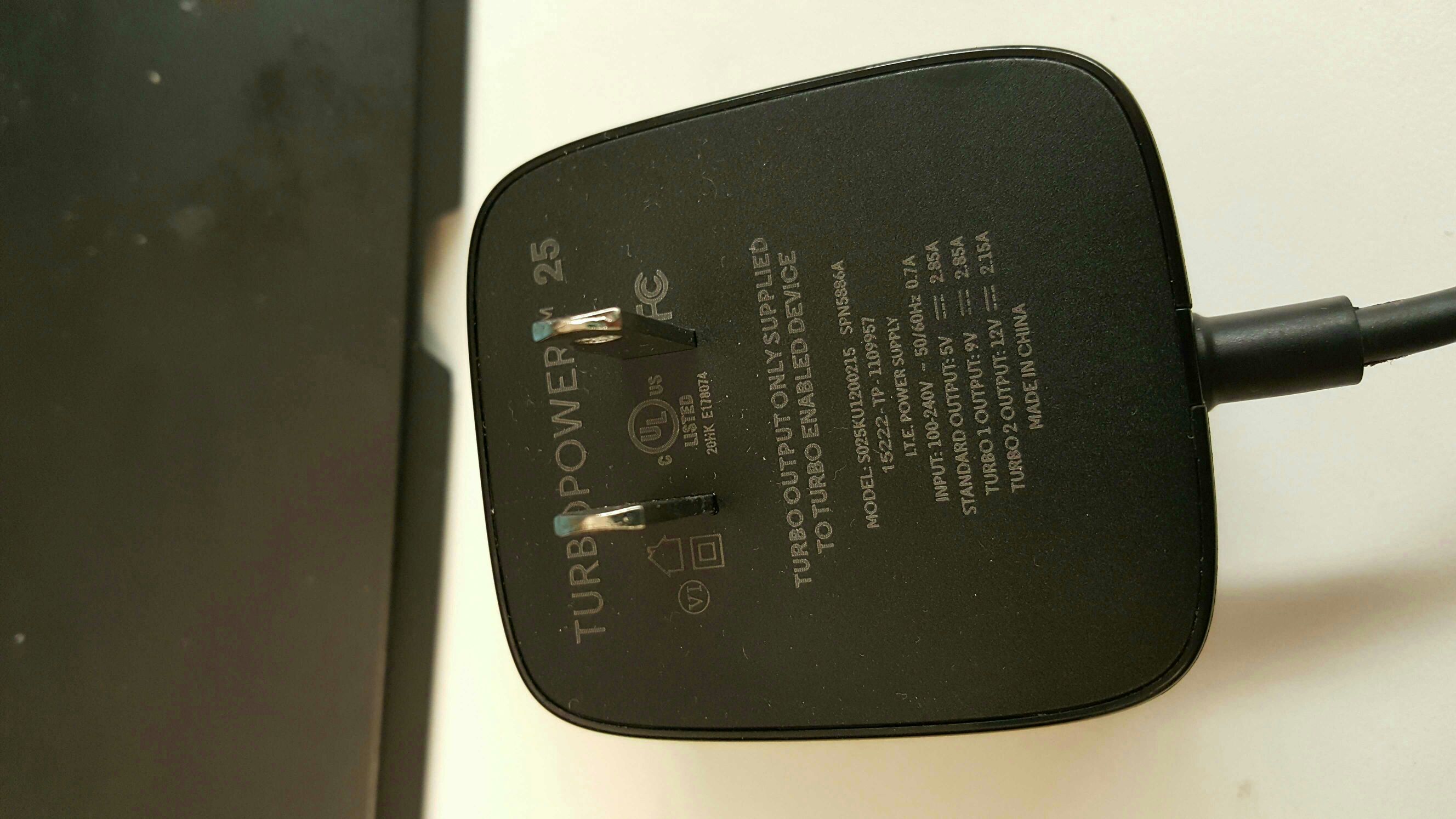

The Samsung adaptive fast charger is rated at 5v/2a or 9v/1.67a.
But the maximum amperage of the turbo charger 25 is 2.85a at either 5v or 9v for the stock charger.
However for the test I used an aukey Quick Charge 2.0 car charger, and I will use the same for the note 5 test. Peak charging speeds don't really matter anyway as on the turbo 2 it gets heavily throttled once hot.

Peak charging currents do matter, it's what builds the heat. If the T2 is charging at a higher current for a longer period of time it will get hotter (simple physics). Now, if you show data to the contrary where the Note is drawing similar current for a similar amount of time, then I'll happily stand corrected. I don't mean to sound harsh, it's just that a lot of people read forums and labeling the T2 as an overheating device isn't fair at this point in time.

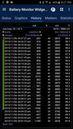

As I had guessed your peak charging currents are half that of the T2.
Personally I care more about a consistent charge rather than a high rate of charge for the first few minutes and then trickle charging afterwards.
Of course if you plan on using navigation for 7 minutes or less then the turbo 2 implementation is preferred, but over 7 minutes, the note 5 implementation is preferred.
