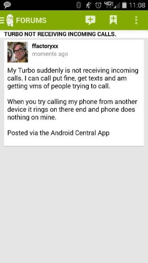

My Turbo suddenly is not receiving incoming calls. I can call put fine, get texts and am getting vms of people trying to call.
When you try calling my phone from another device it rings on there end and phone does nothing on mine.
