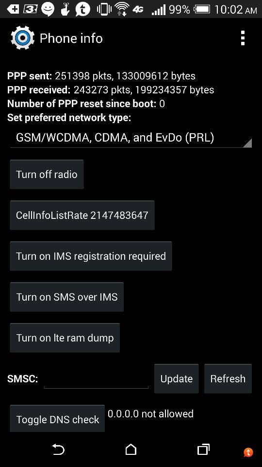

Dial *#*#4636#*#* in your phone and it will bring up all your network preferences.
Click on phone information, scroll down to where it says select preferred network type. Its right above turn off radio.
Change the network type to this:
Then just back out of it and you'll be good. You'll be using hspa+ I believe instead.
As far as I remember, this setting won't survive a reboot, and if you want to change it back to LTE, go back to those settings and change it back to what it was.
http://img.tapatalk.com/d/14/04/17/dy9ybe5a.jpg
