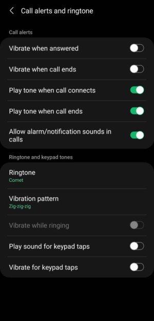

@mustang7757. If I receive a call I get both a ringtone AND a Notification which is triggered by the phone call. I do not want the notification in this case as the ringtone will tell me that the phone is ringing. When I hang up the phone call I now receive a notification that the call is ended. I do not need this as I can see the call is done.
However, I want all the other things that notifications tell me such as SMS or app notifications. They should alert me whether I am on a call or not.
Ok , ill look into this
This option is on my unlocked Note 20U with Att on andriod 11 , so you probably dont have this option in phone settings and dont see a way to do what your saying, maybe try Google phone app Screenshot_20211012-145544_Call%20settings.jpg
