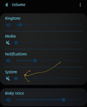

Have you tried this?
-Go to sounds & vibration
-Click on volume
-Turn of system
