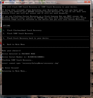

I'm trying to install Cyanogen Mod 11 on my Galaxy Nexus device. I started by doing a factory reset with the Team Win Project Recovery. Then tried to install the .zip containing the ROM, but it failed. I restarted my device but now I can't get to the recovery screen. I attempted to flash a new recovery but I get this error: FlashingRecoveryError.png
I'm quite desperate cause I can't even get to ADB now. I appreciate any kind of help or advice.

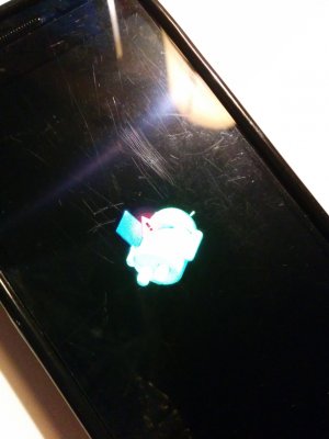

If the toolkit your using has a option to flash the factory images I would try that to get out of this problem. I know its the long way around but at least then the device would be reset and booting w/ stock Android and then you can unlock/re root and try again w/ CM.
So once you see that screen press and hold POWER then tap volume up a few times and it should enter stock recovery
