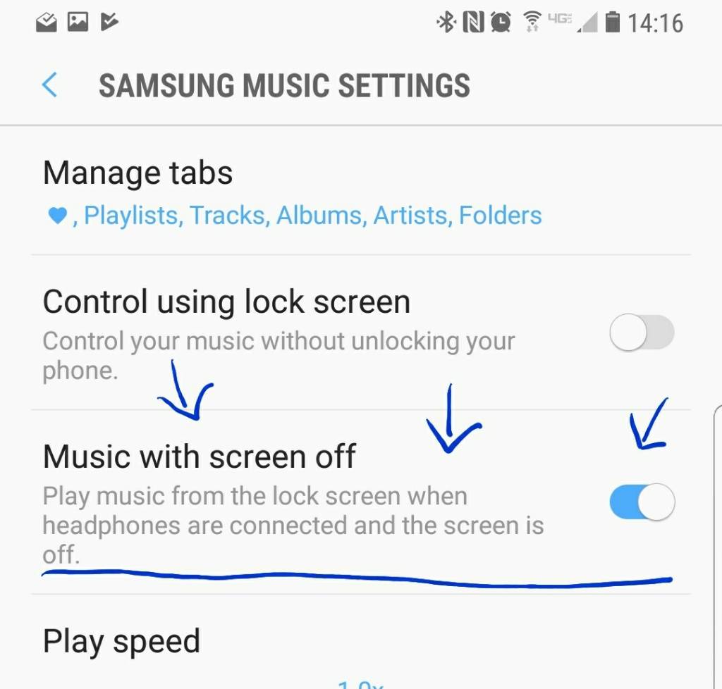

Actually here you go...
That option is to have music controls on the lock screen when the phone is off - it has nothing to do with BT automatically playing music when connected... I have the same issue, and it's really annoying when getting in my car, and connect the phone to watch videos, instead music starts playing automatically

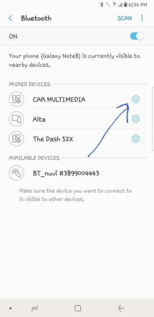

Could try turning the connection off in the Bluetooth settingsView attachment 272125View attachment 272126
That will stop playing media through Bluetooth car. OP is asking how to stop it from playing automatically. It is a bit annoying sometimes. It happens to me all the time.
