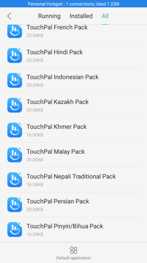

i think i found the soultion after some search from your link
here is the soultion for all ---> stop and disable your TouchPal

TouchPal is notorious for adware and possibly worse. I recall that some phones have this preinstalled as the default keyboard, which is terrible. I agree that you should Disable it, but make sure you have another keyboard app installed first. Otherwise, you might get stuck being unable to enter some important piece of information, like the PIN/password on the lockscreen.
That's a problem on my phone also but unlike other phone mine cannot be disable what I did for now is cleared the data and so far it's not appearing
My phone OS is colorOS v5 it's an Oppo a37fw so the settings are quiet messed up
I have the same phone, just install gboard and force stop tuochpal and other additional language for touchpal.. it work for me
