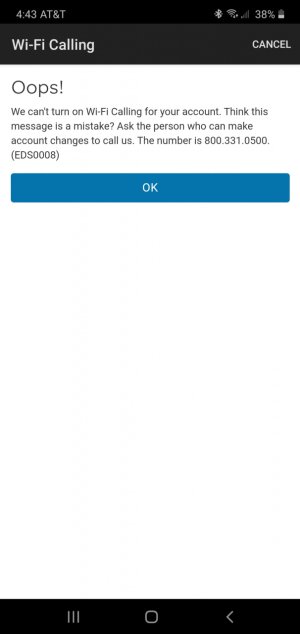

first I have read and read and read.....and I still am unsure if flashing to a carrier firmware (ATT) on my unlocked Note 10+ gives me WIFI calling.....yes or no?? I flashed to ATT firmware and the icon is there, but i keep getting the "OOOPS" message, saying that it cant be activated. I called ATT and was told even though I have ATT firmware, they still cant get WIFI calling to work..

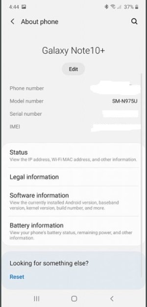

Can you show a screenshot of what your seeing?

yes....i see the wifi calling option in the phone app settings, but it just gives me the "oops" error message

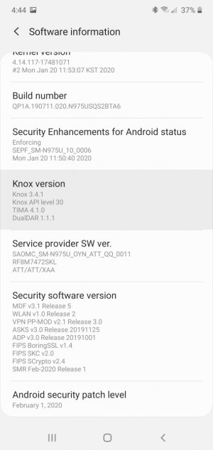

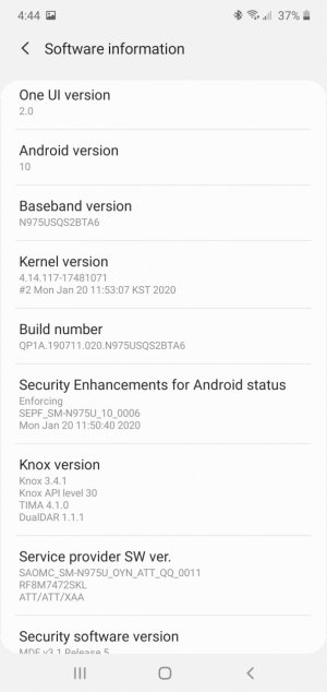

followed the YouTube video I attached...here are the written instructions.. https://techvalor.net/kb/viewarticle?a=53
everything works, have the options for WIFI calling, Visual Voicemail, all the ATT animations and bloat wear....get the "OOPS!!" error message when I tried to set up WIFI CALLING, and constant error message with VISUAL VOICEMAIL saying you need an internet connection to use visual voice mail on wifi and wificalling
Yeah if you extract the zip.and placed each in it's corresponding 4 slots in Odin it's correct .
